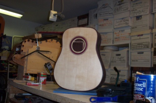

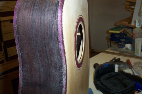

Does it mean i should bind the fretboard with purple heart as well? Would it be too much? And what about bridge material? should i use purple heart or EIR? Here's a pic of my box so you don't have to scroll up!
TIA guys!

Nice work Serge! I like the purple against the Rosewood. When you get it all scraped flush, get us some close ups!

Thanks Lance, that's exactly what i had in mind, as i'm scraping, it looks better and better, a bit of crack filling where the seating was not made properly tho but it is really encouraging!

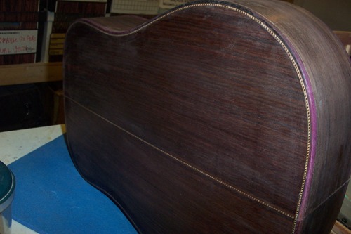

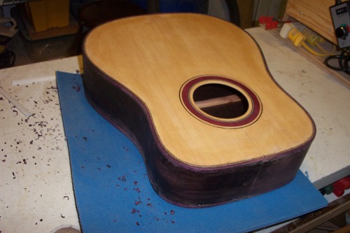

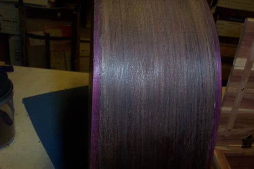

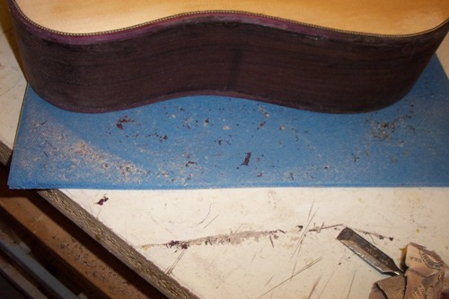

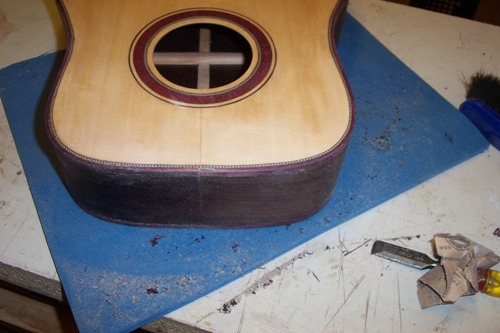

PostPosted: Tue Jun 06, 2006 3:22 pm

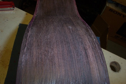

Well Billy and Lance, you guys want somethin' smokin'? I got SCORCHIN! Brace yerselves!
before the sraping ...
and after...

I also want to thank my bud Alain for the scrapers he gave me and showed me how to use, very useful tool!
